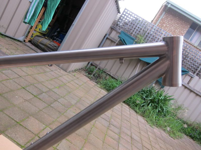

Headtube Junction - very clean

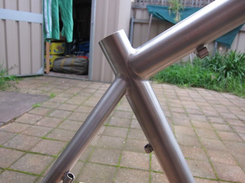

Seat Junction
Some nice braces on the stays

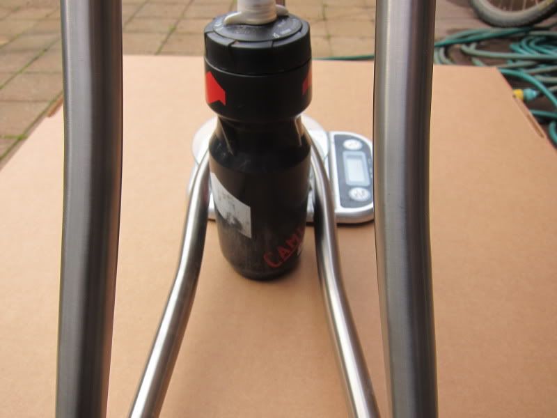

Good clearance! - that's a fairly chunky Camelbak Podium bottle

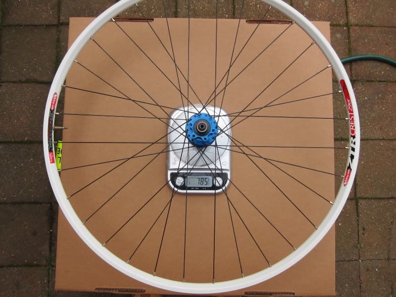

Front wheel
Rear wheel - a 1.7kg 29er wheelset isn't setting the world on fire but it's a nice strong build with the Super Comps. At 80kg they will allow me to run rigid if I ever grow some bollocks
