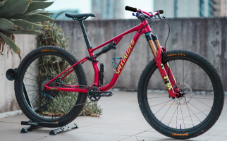

I usually avoid the matchy matchy grips to pedals etc. that most people do to their bikes, but the orange fork on this pink bike continues to do my head in so I’m trying everything (in this case some matchy grips and pink alloy bars). Functionally the bike is awesome, but visually I think it looks like balls.
This is 10000% a me problem though lol. I usually get to a place with a build where I think it's "finished", but this pink bike is, at least visually, a farkin challenge. I think at least I'm mostly over the weight weenie thing though. Last ride out I had the insanely light straight carbon bars on, and whilst it was doable I do think bars with a slight rise and proper grips felt more fun. Keen to try some higher riser bars but the rear brake cable is way too short (urgh...), could be even more fun though!
I think a you problem, I reckon that looks farkin awesome. Pale yellow with the orange and pink/red definitely works.
Time for the fork lowers to be dipped?
Black or paint matched to frame?
Yeah I'm not baller enough to buy the shiny black version of the same fork that's for sure. My issue is more with the pink frame than the orange forks though, maybe?! 😅
Then again. If I was going to buy a Bronson. I'd get one in Kalimotxo 😅

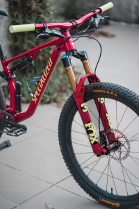

Dropped in to CCACHE today to pick this up.
Decals are upside down sadly lol. I don't mind tbh.
Also some orange bling from Better Bolts.
Better bolts Fox fork top caps in orange and a FOX Factory FLOAT SL EVOL SV 190 x 40mm which I picked up from CCACHE today. The FOX is 88g lighter than the RockShox Deluxe Select+, should be a bit more plush too!
Just need a Kashima Transfer dropper post now ;)
I thought about it, but they're heavy! There is an SL version that only has 2 positions, but it's only 100mm of travel which kinda blows. Would work OK though if I ever decide to keep it as an XC/weenie/29er setup, but then I'd have to take off the orange fork lol.
