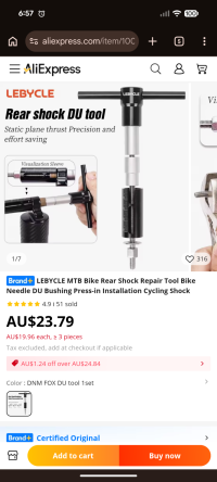

After swapping out a rear shock the other day and realising that I had to do the old socket and vice number to remove the mounting hardware I decided to make a tool after work today. Bloody works a treat.
