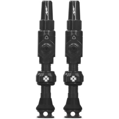

I've found these to be good when facing similar shitfuckery, deletes the valve stem all together.
They sound good but there are reports of them snapping at the bottom.
A friend snapped a normal valve the other day with a rock .
Fortunately someone had a new valve ! However because you have to take the old one out, you break the bead and it needed a CO2 canister to reseat it.
