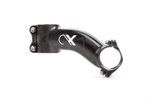

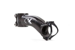

Unlike when you're buying an AX lightness stem....
