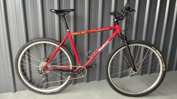

I’ve got a really nice Salsa Ala Carte 26er frame. It runs a bit small on me, but I still love using it as a general cruiser and around-town bike. I currently jammed a 29er wheelset in there with 45c tires for fun, but it's definitely not a permanent setup.
I already have another 26er and a couple of 29ers in the stable, so I have those bases covered. I also have a pair of Chris King hubs and some 650b rims ready to build up, but I’m having second thoughts. Is converting this Ala Carte to 650b worth doing, or should I just stick with a proper 26" build?
Would love to hear your thoughts or experiences!
Pic of current set up attached

I don't think 584s will work in that bike; there's not much rear clearance as it is with the 559, and at the front, even if you have clearance under the lower leg bridge, there's a very high risk of the tyre fouling on the crown if you go deep into the fork's travel, and that can get messy.
